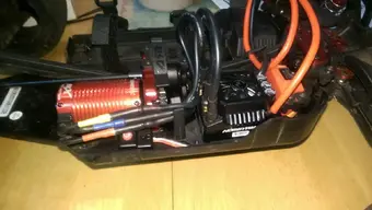

Talion Updated esc to Hobby wing Max8

After the upgrade the Talion is like a different animal. Insane power no more shut downs or power lag.

Nice! Was it difficult to program?
Nope, comes with a program box made it easy.

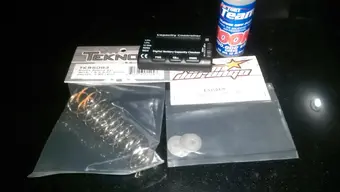

Also shimmed all the diffs and put 50k/100k/10k in makes a huge difference wheelies on demand.
Swapped rear springs for Tekno Orange and moved my stock rear springs to the front.
What pinion are you running. Im thinking of putting my stock motor back on..so i can learn to back flip it of little jumps. Want to show off the power of the truck
The bigger stock pinion that it came with not sure on the T count
i just ordered it today...does it bolt right in or did you have to do something to make it fit?
it doesn't bolt in you will double side tape it in with the tape provided.
The only modification I had to do was to grind the lip off the servo mount tray with a dremel, took 2 minutes.

I got a question did you wire i. The cap or just left it out. I just got a max8 and i don't want to ruin 8t like i did the hobbywing xerun 150a
I don't really understand what your asking. The only wiring thing to do was sotter the connectors ( female) so the esc can connect to the motor. Everything else was plug and play. I like the esc. No more shutdowns :)
I don't really understand what your asking. The only wiring thing to do was sotter the connectors ( female) so the ESC can connect to the motor. Everything else was plug and play. I like the ESC. No more shutdowns :)
Mine came with a cap that they said if the rc weight over 7 kg to solider it in
