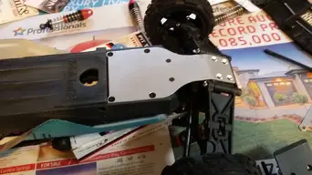

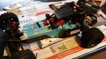

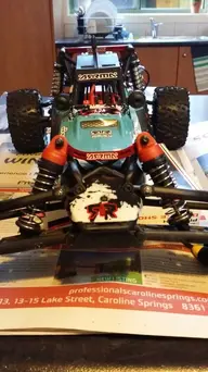

Hi guys just upgraded a few things on my mega raider put some integy shocks. .rear were a direct fit but the fronts the lowers arms need to be filed down so project has come to a halt on the front shocks. Put front a rear shock tower brace and lower bash plate. Motor and ESC upgrade on hold as not sure if I want the kids charging the LiPo's and the forgetting about them.

I don't know exactly how the Integy shocks looks like, but I don't think you have to file down the lower arms. I had the same problem when I changed to new shocks, the steel balls was too wide, so I just moved them over from the old ones. Plus I had to put them in the outer hole in the arm.
Maybe it works for you too.

Thanks @solidbase I'll give that a go I got the flu atm and not thinking straight lol.. I'll try that thanks again..
