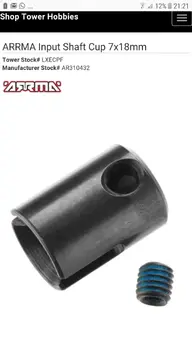

also the protruding metal rod is curved throughout but has a small flat patch is that where the shaft cup's small hole should align with and there the small screw should be put in....also i don't think it can cover the entire protruding length
oh and i just noticed this...that old small screw never came off i guess its still inside it just lost its head ?

and got the screw out as well now.....will put it back in i thought it was supposed to have a head because of this pic...screw no head.webpbut realized now that it's the base and not the head..

Best be to screw it out with a hex and put a new one there that already has blue stuff on it...loctite or whatever it is
