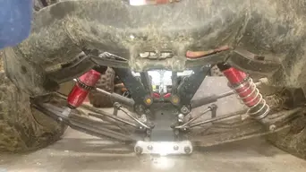

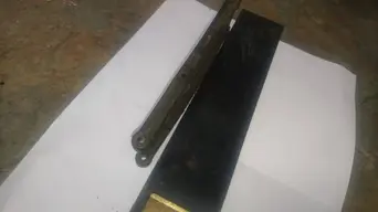

Hi guys. I have been searching these old threads looking for an answer. I have snapped the rear LHS shock shaft on my kraton 4 times in a row in exactly the same place as shown in the picture (only doing pretty small jumps). My kraton is a V1 however I modified my rear shocks to take the Tekno 4mm dia shafts and also made aluminum pistons and shock ends. Has worked well now for a couple of months but then snapped the rear lhs shaft first time - welded it then it snapped again so I tried the stock 3.5 mm shafts again and have snapped two more all inside one week! The rear droop seems to be set fine. I am running stock arms and so have removed them and they seem a little bent and possibly a little too flexible. Maybe the stock plastic degrades over time so I have now ordered rpm rear arms to see if this helps. Would appreciate any help or advice guys - maybe I'm missing something more simple!
What tires are you running?

Can you push your truck down so the chassis is flat against the ground. If so, do you have any travel left on the shocks? I can flatten mine and still lift a tire a hair.
I'm gonna have to do a quick rebuild later to check that one out as the rear end is torn down at the moment. Will get back on that - thanks!

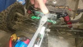

Looks like you nailed it man! When I push the truck down flat I can lift the RHS wheel about another half an inch before the shock bottoms out but as you can see in the attached pics (of my v dirty truck!) the broken LHS shock has totally bottomed out. Now I just need to figure out how to fix it! My shock tower is nearly perfectly straight, the shock mount bolts are straight and the chassis is not twisted. Some thinking to do!

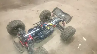

Still life left in the old dog yet! Old rear arm was badly bent so have replaced both rear arms with the RPM ones and going good!
