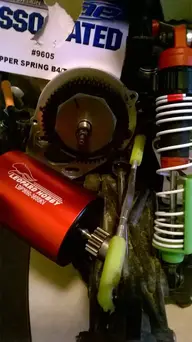

I installed, a 3650 3650kv 4 pole leopard motor, with a new 57t arrma spur gear 0.8mod/32dp, and new slipper pads. Also, the associated slipper spring #9605 fits perfectly! And I went back to the stock 13t pinion gear because, I'll be ordering a green integy heat sink. Motor temps will be kept in check.
This is NOT, a properly mounted motor! Lol!
Your turn! :D
