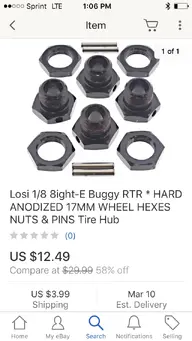

Several different types .. some also with closed cap nuts to keep dirt off threads...but the Losi 8ight 17mm hubs are high quality . Perfect fit but you need a thin 8mm ID nylon washer to shim works well
Extended also
The od of the arrma driveshaft is 8mm... any 8mm id 17mm hub will work.. just may need a small shim to take up slack ...

A shim is never a big problem. The left one are looking good.

Thanks for the responses! Good to know I'm not the only person who's run into this issue. I'm going to try and pick up a set of those losi hubs, be diligent with the loctite and hopefully I won't have the same problem. Anyone have a part number for shims that fit that 8mm output shaft?
