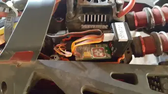

No problem... i have a pic if the reciver box rite here... any other questions feel to ask. Ive had it apart and back together a few times.
