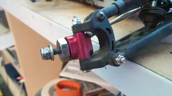

Hey guys the parts I used are:
AR320162 Aluminum rear tower brace
AR330148 Aluminum front tower brace
AR320157 Aluminum front hinge brace
AR320162 Aluminum rear tower brace.webp AR330148 Aluminum front tower brace.webp
I used the red motor plate and the red skid plate as well but those were just for bling.
That's the Traxxas Aluminum steering knuckle, Needed it in a pinch when I was racing but it works great.
I shimmed out the rear stub axel (Blue shim, its associated and coned, I actually thin that's what it was designed for), because a lot of people saying they were snapping dog bone, and based of the play I thought it was the stub axel catching on the rear arm, don't know if that was the case or not but I've never broken a dog bone since I've had the car
I'm currently using the Mojave body, direct fit. The extra holes you see on the front are for when I run it on my Durango DESC210.
Pics with the Shocks on it(no limiters, although I probably should put some in).
The Associated Ball diff I use works the same as all the Blitz diff right-ups you see, I just used an Associated diff for parts convenience.
Now if I could just find some CVD's that fit I would be golden.
Hope this helps guys, Sorry if some of the pic a to large
I've had the car since it can out, so I don't really know what the current line-up comes with or doesn't as far as aluminum parts and turnbuckles, I'll leave that to you guys.
