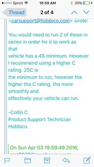

Spoke with arrma direct. And they said 25c is the minimum rating. But recommend a higher one.
Heat, puffing=short battery life. ESC won't care for it either.
A 4000 mah pack should be about 40C minimum. I wouldn't risk that, even.
Hey, as long as you aren't doing any speed runs and just putzing around and not doing a lot of full throttle I'm sure it will be fine.
