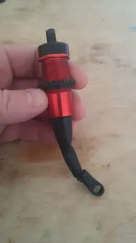

Kraton Will these work on Kraton?
Trying to see if these will work on a Kraton. Can't find the measurements any where.
Gonna say yes because the Kraton is a basher, budget version of the high end durango dex8t racing truggy. Durango and arrma are owned by the same company. Why do you want to buy different shocks, stock work great on a basher monster with stiffer springs and oil?
Cause doing this too much

it may be easier to change stocks ? they are cheap, got a handful of Pro stock and change on health , almost every day of break )) And the springs I got from TEKNO orange....
SPS468......that bent shaft is caused mostly from lack of driving skill....happens to me all the time. :) Any shock will bust. Most monster bashers don't have expensive shocks on them with all the fancy coatings etc. They do have good cheaper shocks on them that get the job done for bashing. They can be stocked up on quite cheaply. However....the Tekno shocks have something that can justify some extra strength. They are 4mm shafts and the ball end seems to be very robust. The Durango's are probably just slightly shorter Kraton shocks with fancy wear preventing coatings on them. (Maybe)

The Team Durango plastics are exactly the same as Arrma's, and I highly doubt the shock shafts are any different. They might have a coating on them, but that won't prevent them from bending. A relatively cheap way to find out it's to just replaced your Arrma shafts with Durango, they should fit, but you'll want to verify that for yourself.
As Vanning said, the strength you're seeking comes from thicker shafts.

Alright, I'm back to eat crow... Upon further research, the Team Durango dex8T shocks do in fact have 4mm shafts. Both the front and rear appear to be a few millimeters longer than the stock Arrma shocks, but that shouldn't be a problem. Based on this info, they should make a great upgrade!
http://www.team-durango.com/part-info.php?partNo=TD330721
The Kraton measures 3.45 mm the Durango is 3.81. I wonder why they went a little thinner ? I wonder if a slightly thicker shaft would fit into the red shock body of a Kraton ? Just by looking at the black o-rings, they are a little hard so the larger shaft won't fit that. Maybe Durango shafts and a rebuild kit to save a little money ?
The o-rings, o-ring spacers and shafts are available for the Durango. The shock body may have to be drilled out slightly on the Kraton to fit the larger shaft. The o-ring spacers look a little different. Idk... just a though.
