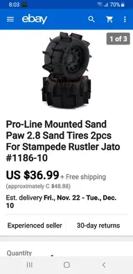

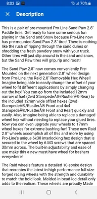

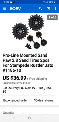

My granite uses the 12mm hex. I'm buying the tbr ski kit. These wheels will work fine with the granite mega 2wd correct??

I believe so. I don’t know much about the old Granite but these would not fit the new one.
You would probably want the wheels for the Stampede 4xx4 and Slash 4x4 not the Rustler/Stampede/Jato, they have an offset the Rustler ones do not.
If you want to get from 14mm to 12mm you can.
https://ebay.to/2X5i8f1
You'll then be able to fit common 12mm wheels.
For the Mega 2wd not the Mega 4X4.
They come with narrow and wide offset 12mm removable hex inserts so they should fit. But Yeah if they weren't the Proline removable hex wheels you would want the ones made for the front of the 2wd Stampede not the rear.
Oh I didn't see they had the removable hex, carry on.
