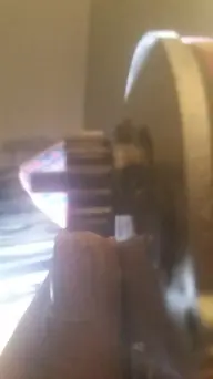

Hey guys, i have the FURY BLX and iam wanting up up grade my pinion and spur for faster speed.
My pinion on at the minute is 15 and wanting to put my 17 pinion on.
I have a 57 spur in and wanting to put my 54T spur on.
My problem is my 15 pinion which is on my BLX motor is stuck i can not get it off.
Ive took the little screw out and it still will not come off.
Can Anyone help me solve this.
Thanks

The small set screw is locked by screw-lock-liquid.
Just make them hot and loosen the screw.
Useful is a solder iron for you're situation!
And while replacing the gear put a bit loctite on the screw again. Otherwise you will to lose them.
Please do not give any force to the motor shaft, if its too much you will damage them.
Take spare Allen wrench,heat red hot,hold in screw head couple times, remove with cold good Allen wrench. For pinion only ,heat gear a bit with Benz torch an pull off with pliers or pry with drivers. I did on stock 13 tooth.
Thanks for reply mate ive managed to sort it all up to TOP SPEC now cheers buddy
