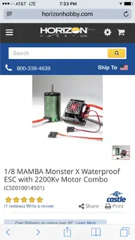

Thinking of upgrading to this for my Kraton

The ESC is excellent, the motor may run hot on 6S. It gave me issues in my Kraton. I had to run a very small pinion, motor fan and Proline Badlands to try and keep it cool. It will be best on 4S or 5S.
I find that odd. I've used Castle motors for 7+ years and have had nothing but good luck with them. Not saying it isn't true in your case..just odd. I've always considered them the industry standard.
Who said anything about the quality of the brand ? The motor quality is great also, being that it is a high KV may be why it ran hot in a heavy 1/8 scale Kraton on 6S. The Kraton is a 6S truck so I figure I would share how it did in my Kraton on 6S. It ran hot and shut down the ESC often. .. still a fantastic motor but maybe in a lighter vehicle on 6S. On 4 or 5s in a Kraton.... it would do better and also suck up the mah's pretty quick.
I apologize, I must have misinterpreted your response. Certainly wasn't trying to be argumentative.
It's the same motor that came stock in my Savage Flux which is considerably heavier than your Kraton. Never ran hot, even with upgraded pinion and on 6s, hence the reason I found it odd. There are many factors that lead to engine heat, including the terrain that it is being driven on and driving habits. This is the reason I said that my experiences may not have been true in your case. In my case, it has caused zero issues, including heat in a heavier truck.
Definatly a quality brand but normally a higher KV like a 2200 will run in the higher heat ranges in a heavier vehicle. Final gear ratio plays a big role in it also. At the time... I could not fit the pinion and spur I needed.... so I installed smaller tires to make it better. Funny thing is.... I didn't expect it to run very cool at all on 6S but it thermaled often off-road so I gave up on it. Insane power but ran too hot with smallest pinion and tires. That ESC is fantastic in a Kraton but there are way better motors to use for 6S. Same speeds, cooler temps, longer run times can be achieved easier.
On lower cells, it would not matter. It is a 6S rig so why not go for a better choice of 6S motor.
That's why I opted for posiden motor with the momba esc... cant wait till they arrive..

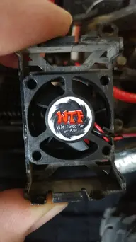

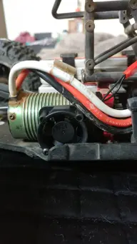

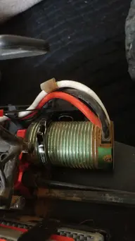

I have this setup in my Kraton. I love it! The motor does run a tad hot, but I installed a wild turbo windy fan on a 3d motor mount from wild turbo this evening. Haven't ran it yet tho. That being said I have abused this setup, just keep an eye on the motor/ esc temps. Good batteries will also help with esc temps as it will help keep ripple down.
Im also running a 17T pinion as my 15T went away when I sold my nero. And I have replaced my esc fan with a wild turbo 30mm fan. It should help stay cool as ot spins at a much higher rpm than stock.

Does the Wild Turbo fan fit inside the MMX shroud? Seems to in the pic. What size?
Ordered 2 wild turbo fans to replace my ESC and Motor fans. If that does not improve things I'm buying the BLX200 to go with the Nero motor, which is basically a MAX8. Just to try a different ESC.
