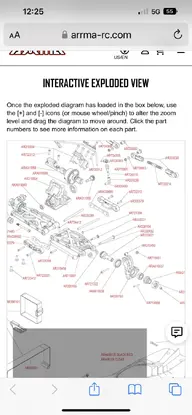

Yes I use stock drive shafts I’m not going all crazy w it I buy new and replace as needed or maybe if I run it hard I’ll just replace drive shafts all around
Here is the blown up diagram of my rear end, diff cups and rear wheel. Doesn’t show anything on here and this is on arrma website
According to the Arrma website now, the only EXB available is the 1/5 8s OC roller.
But the 6s EXB's all came with the Rear Outdrive inserts. In the EXB manual should show the blow up of the inserts. The inserts just carried over and are installed on the RTR variants now. Even though the RTR blow up does not show it. This is common for Arrma to ommit or add parts mid production, never updating the manual, Until the next revision model. Even my TLRT Typhon came with the Rear EXB output cup Inserts out the box.
