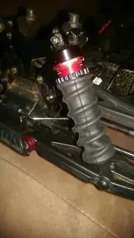

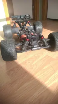

I also forgot to mention it was on my Talion. But here are pics.
Cut a little longer then the spring and wrapped around the top/bottom of spring. Only one ever came out and ended up torn. Replaced and never had a problem again.
View attachment 1992 View attachment 1993
