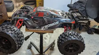

I built a 1/2 Kronos xtr with 1/2 kraton 6s exb parts need upgraded drive shaft to handle max 6 combo with a 20/ 47 pin spur

I run these 6mm cvds on my Xtra wide mojave, probably 10-15 packs through without issue. The problem with going larger diameter is you'll get interference at full droop and shock travel articulation with the output cup/arm.
https://www.amazon.com/Thickened-Dr...1_4?keywords=kraton+cvd&qid=1691172268&sr=8-4
I relate, having a Fireteam. With the wide arms. I find that you need to limit full shock compression with 5mm shock limiters at the front to prevent issues best. I use stocker CVD shafts. No popping out at the Output cup issues now.
I also am running dual shock towers 5mm 7075 and 5mm carbon fiber with gpm 8mm shock shafts with outcast 8s wing and wheelie bar
