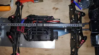

I bought the parts and I assembled it.
The only problem I have is that the body doesn't fit unless I use some rings.
Did I assemble something wrong?

Since you bought this used, does the chassis still have the front kick-up? Some bone heads straighten this, thinking the bend is from a crash and not supposed to be there.
Did you run it already or did the person send it full of dry grass ? Lol, just kidding.
It looks like it was in a serious crash in the pictures with all the grass. It appears to be bent up pretty good. It doesn't take much to throw off the body post locations.
What about the sway bar in the rear... That looks like it's a little questionable also.
It looks like you purchased a relatively clean Kraton that needed a new rear end. Well... the next few pictures looks like it's all crashed up. Get it all back into shape and look into making a chassis brace. They help to stop the body posts from getting out of spec. A bad crash is another story. That may require new parts or a date with a hammer and a good heavy vice.

I'm also working on the diffs. Thats why I looks like it has crashed.
The front kick-up seems to be there. When I bought it, it looked like the car had been used as a donor, since there was not a single scratch on the plate....
Well.... since the car works, I will continue to run it and when I meet someone with the same car I can compare them.
Ahhh I see. I would say you bent the rear shock tower back. I did that to mine, it doesn't take much to do. That's why I don't run a wing or a truggy body.

Well, i mesured the length between the shock towers and in my Kraton it's approx. 38,6 cm
I wonder if thats different compared to other Kratons
