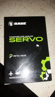

Yup servo was bad.... pulled it out I got a new one In it and works awesome
