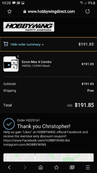

Just ordered the power plant. Should be in the next week or so.
