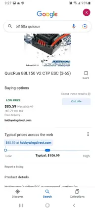

I'd go with mm2 an tp3650-2350kv if 80ish mph is your goal..it would be about 250$
Or a cheaper route I'd go with this 150a quikrun an 4068-2650kv for 150$

So this motor would be a simple drop in my stock motor mount of v3 blx?
And this motor esc combo would be better than what is offered from the arrma set ups?
