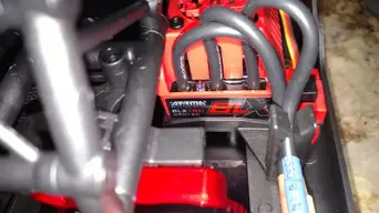

Well I might have the new 185 if you received one earlier! Either way I will go with a Castle system if I have trouble with the ESC. Thank you for the information. It is to bad they can't build a good proven system.

That is the updated BLX 180, see the black decal across it, the old one BLX 180 had a red decal.
I had the updated BLX 180 on my Kraton because all Arrma Kratons build after August 2015 are updated.
But Arrma's newest 1/8th scale ESC, the BLX 185 is what they sent me, they said it would be better but it turned out worse.

OK thanks for the information. I will keep any bad or good feedback on here of what my updated BLX 180 DOES. THANKS AGAIN.
