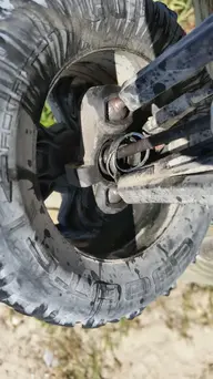

I've only ran about 10 battery packs through my Kraton. I'm getting annoyed at having to replace front inner wheel bearings. So far I have had to replace the left side once, and the right side twice. It's obviously something that needs to be addressed.
Can anyone recommend any fix or mods for this? Bearing suggestions would be appreciated too. I didn't use ARRMA original bearings to replace the Shattered bearings. I used standard, blue rubber sealed bearings and they still Shattered.

Has anyone else had such bad luck with the front inner wheel bearings failing on the Kraton as often as I am experiencing? The problem is that when it breaks, it wrecks the steering block as it splits the plastic from too much pressure. If it happens again, I will also need to buy the composite steering block set AR330187 as I have now used up both steering block pieces from my other bearing failures.

I've been doing some searching and it seems this was a pretty common problem toward the end of last year. The bearings where blowing up in the steering knuckle due to the design of the front steering hubs and how they slit right on the lip.
Arrma has since updated the knuckle with a thicker design, as you've already seen in the AR330187. My recommendation would be to buy the new knuckles and get some good quality bearings and that should help if not completely fix the issue.

My experience is that even high quality bearings fail when driving hard. After changing to the beefed up knuckles (as Woodie wrote), I have had no problems. With the original ones, I had to change bearings every 2-3packs. Both front knuckles had small cracks which I guess made the bearings want to dance tango.

i had the same problem realized my dog bone was bent got me some new ones and some ceramic bearing and haven't had an issue since.
