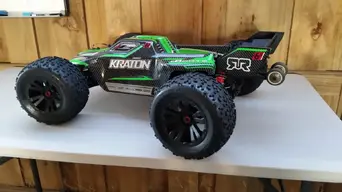

Hi guys, got sick off putting the Kraton on it's lid when I powered off.

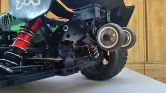

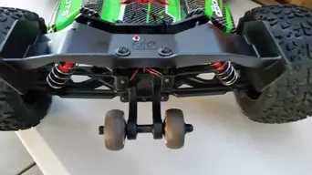

So went to Sik Hobbies to get a Wheelie Bar. No joy, was told they don't make one for the Kraton, I knew that Vkar Racing made a good one. Went ahead and purchased it knowing that it would not fit, but no worries knew I could build mounts for it. (Out of alloy, painted black)
So here is the finshed product, works fantastic, can hoon down the road on the rears and the Wheelie Bar no problem. I'll try to post some photos.
Wheelie bar looks good.
What is the red button on top of the wing?
