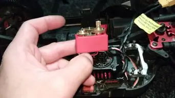

Well I stripped out one of the gears on the servo and i after i tore it apart i realize i don't remember how to put it back together. I am not able to find a diagram or anything showing how to put it back together. IDIOT move and NOOB move also any help please.
Thank you
This is how I think it goes together,just gotta fill it with lots of Vaseline an see if it works

I have not torn this particular servo apart, but it is like all of the different servos I have torn apart.
But please no Vaseline! It will destroy the gasket making it not water proof!
Get some white lithium grease.

To late for my gasket now but I've ordered a new servo, so I'll have a spare one now.
