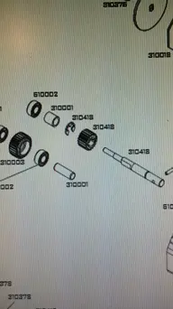

I'm still running all the stock gears in my fury after installing the castle creations sct combo, I did have to drill out and add a longer pin to the gear #310418
