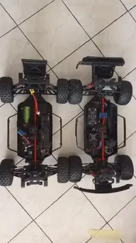

After a year of fun with our used bought Mojave, i decided i wanted a second one.
This time i decided to build it from scratch, so I can search parts and build it the way i want.
Starting with the stock chassis and towers, that are left from all the upgrades to the first one.
It will be a mix of stock Arrma BLX, EXB and third party parts. I'll be sourcing and ordering parts gradually, so i won't have to spend close to €1000 all at once. I'm hoping to finish this build before summer.
This is what i got so far.
There's too many parts still to come to assemble yet, so i am just mocking things up for now.
I still have to decide on ESC, servo.
Not sure i want to keep using this CC 1520 motor, but i'll give it another try.
I was planning to use the same configuration as my first Mojave. Which would be using all BLX diffs. But now Jennysrc accidentally sent me a EXB center diff.
What fluid would you guys recommend i'd use?
I'd like the EXB diff at least as stiff as my BLX with 500k weight.
Also. I am definitely not buying another MMX8S for this one. Thought about getting a Max6, as you guys seem to love these. Or maybe a Torox 185. Would that one be sufficient for handling the 1520 or 4995 motors?

Update:
I finally got my parts from Jennysrc. They have been in customs twice as long as it took to ship to The Netherlands.
It took me a couple of hours of wrenching and now i have a roller.
Since the BLX 185 isn't strong enough to run my 1520, i decided to run the Spektrum 2050 (warranty replacement for the BLX 2050) for now.
I am getting back on my statement that i won't get another MMX8S. It has been reliable so far, with plenty of power, smoothness and absolute waterproofness. (I've been hosing all my rigs down after use and never had a single problem with that).
My current setup in the first Mojave definitely is worth copying to this one. But for getting it rolling, i still need a servo and another flysky radio. I am not setting this car up with those awful beep menus on my current radios.
(Yes, there's a Traxxas receiver on the pictures. That's for testing.)
I ordered the Team Corally CS-5245. A 45kg servo.
The MMX8S and 4985 HW motor are plans for the months to come.

Current set-ups:
Both Mojaves have 70 weight shock oil all around. The first one is running all BLX diffs. Arrma metal diff case in the center with 500.000 weight. 50.000 weight front and rear, stock plastic cases. Aluminium diff housings front and rear on the first, alu front only on the build. I got a defective housing and they sent me another one. But i got it to work with some dremelling, so i put it in the rear of my current build. Looking for a cheap one to put in the front. They've been holding up very well, so why use expensive brands?
Jenny sent me an EXB center diff by mistake, but why not try it out? Stock plastic case and stock fluid.
There's stock Mojave springs on all shocks. I might get a tad stiffer later, like on the first Mojave. Heavy motor, ESC and double 3S batteries are too much for the stock springs and the car sags badly. I learned that already.
The stock plastic center braces are crap and i broke one real fast on the first Mojave. I already replaced them with EXB braces, but i don't like how they look and they don't have that notch that fits into the cutout of the chassis. I ordered and mounted black GPM's on both cars now. I did drill out the threads and put longer screws with a lock nut. It prevents me from having to keep buying braces, because the screws broke off.
That plastic center diff brace really had to go. I destroyed it on my first car and replaced it with a red, no name brand aluminium one. It has been fine since. I put another GPM one on this build. I think the top plastic brace is fine, so i'll leave that for now.
Apparently the 1520 can be run with the MMX6S. So i stripped that out of my Slash and used it in the build. So out goes the stock and in with CC.
My first Mojave needs some maintenance, so i used the servo and receiver in the build to make it run.
Team Corally servo, stiffer springs and a pinion on the way. Have to order bumpers and another Flysky to get them both running.
