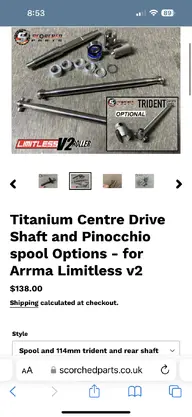

I’m curious which u guys use and think is better. The scorched parts trident titanium shaft and spool or the perfect pass carbon/titanium shafts. I’m looking to order so I can finish just not sure which ones. Thanks all

For speed runners it’s tough to beat the Scorched Trident. Stay away from any shaft with titanium drive pins on the front. Raz uses a hardened steel pin for the front where it goes into the diff cup, but even that doesn’t overcome the extreme misalignment issue caused by the front kick up. That’s why he puts a 180mph disclaimer in his video. The Trident effectively solves the issue, and it’s definitely the best mousetrap so far.
Yea I waited before I ordered it. Wanted to get a few more opinions. Thanks man. I thought the trident was good cause that’s what the 222mph was using I believe when he got the record. David I think. Plus I think with the pp shafts u lose the chassis braces cause of the thickness no?
This setup is what I was thinking

Trident is the best of the best but also not necessary unless you are ready to go over 180 mph.
