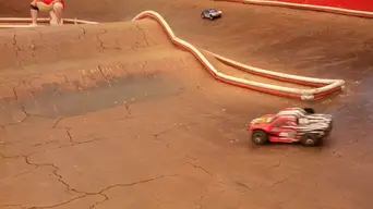

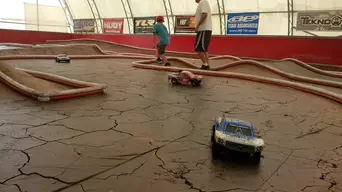

I was wondering if anyone could tell me what they think the run time should be for a Fury BLS running the 8.4v NiMh battery? I was letting my sons buddy use ours this weekend at the track. He only manged to get in about 5 laps before the truck stopped moving. The steering worked but not the drive wheels. I noticed that the red LED was on solid, and the blue LED was flashing. According to the manual this indicates a low voltage protection condition. Surely a fully charged 8.4v battery should provide more than 3 minutes of run time, right? This is the first full battery charged we've run on this truck. I bought it specifically to let this friend of his run a truck on this day at the track.
Note: this occurred using both the new Arrma battery that came with the kit and a 3000mAh 8.4v NiMh Duratrax Onyx battery.
His dad was driving my Fury Mega that day. Two Furies on the track in beginner class. :D
