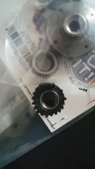

Ok how about this bearing. 15 min. After unboxing 3a lipo on blx granite
From box. To set up controler.put battery in and ran it 15 min. Stock settings on everything. Waiting on parts from arrma. I have purchased metal gear set and does not match .20170324_164907.webp
I'm thinking I need the old housing to make it work.
