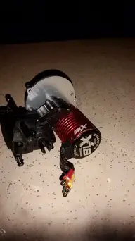

Is there anything I should know b4 I tear into the diff..... and how about gears should I change any to a better gear..... I am a newbie so anything will help.....that's the motor I'm running and a stock esc on an older model Granite BLX

Yea take your time, clean it all out, put n new fluids and greases. Do it where you wont loose stuff

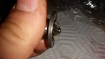

@Darren Wes @WoodiE @Unusual RC.... got it all out and open only o e gear looks messed up... should I replace Tham all....and does any one have suggestions on oil weight... I read a few things on one of the threads but can't find it again...thnx in advace....

My noob side says replace them all because u probably have a warrenty
My experienced side knows it would probably fix your issue just replacing the one
Ultimatly how long do you wanna wait for free replacment vs. Possibly going to the lhs and picking it up.
don't forget to clean all those gears before it goes back in
I believe stock is 50,000wt i would get 100,000wt and start there.
