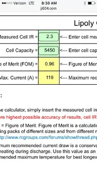

If you want to see something interesting. Here is a snapshot of a calculator used to check my Maxamp battery. You need to use a charger that can measure internal resistance, take the highest cell reading. You also have to figure out if you are getting full capacity of mah. Punch in the numbers and you can get a good idea of the burst C rating of a battery. My Maxamp is rated as 120C. These readings can be affected by heat. It's best to compare packs rather than look at one brand or pack. Its a number game sometimes but also a way to track performance of a pack.
