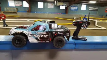

Made it to the track today! Had a blast running the Sportsman class and I finished 2nd overall out of 6 trucks.
Thanks for everyone's input!
