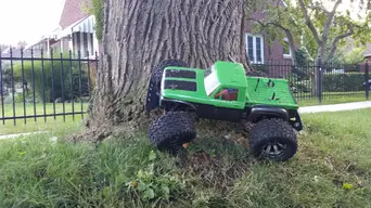

So....finaly after many houers the car is done. Long story short...i had some FYRY sidechassis laying in the workshop, so messured up and started to cut..sand and dremel. Got a DESC210 So i took the front and rear suspension inc shocks ( tjat are state of the art)...just a little sanding on front arms and a direct fit...had to make a new CF tower..the rear end was abolt on..just some arm/axle spacer..habe not adjusted any oil or so..will do thtat this week. Motor is a super sheap SST 3000rpm 2pole with 3s LiPo.and a Hobbywing 80AWP..and a Savöx LP...Tires are Truck 2.2 Badlands on Nitrorustler rims..the hardest thing on this build was the hex...Crapy DURANGO 14mm..had to cut..with a carpetlnife to get them exakt 12mm..working real good.
Maiden run.
O...M..x...G..works like a sharm, good rear end grip, lots of steeeing..even on power..the long suspensionarms and shocks..are...a master combo on this chassi..it just feels like a light 1/8 scale car..just soaks up the bumps..

So after some tuning The MegaGranite is up and running again...new heart in form of Hobbywing 4 pole 3400 motor.
The CVD from Durango DESC210 is slightly short so i talked to my friend who welds all day long...extended 3mm.been throttling hard on tarmac and gravel zero issiue
