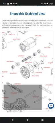

I got my gears in the other day, went to replace the spur and it does not seem to be compatible with the slipper that was in there. Can I modify it or do I need a stock style slipper clutch? The black collar on the shaft seems to be too long.
I want to go back to Arrma parts. Do you happen to know the part number off hand for just the slipper clutch? Everything i found so far comes with the spur. I need the whole clutch assy as there is a piece broken off on the outdrive that goes into the diff.
Oh my bad, it looks like you have everything but the pads, I wanna say it's a mega Typhon!?
It is a mega but I'm running 3s blx motor and electronics.
I can get the gear on but there are not enough threads showing to thread the nut and spring back on.
Hold on let me see it's been awhile since I had to swap a mega.. you might use the collar hell I forget!! 🥴
