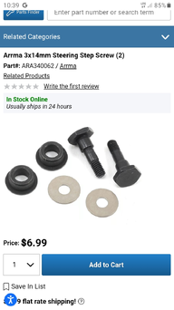

Are you referring to the screws that secure the rack to the steering arms? There's a nylon insert locknut on the bottom side of the steering arm.. it's recessed into the arm. What's likely happening is either the nut is slipping in the arm, preventing it from tightening properly, or, the screw is too short and not fully threaded into the nylon portion of the locknut.
I have fought this battle myself..lost that darned "step screw" twice!! Can't believe I actually found it on the ground both times!!
Also, those flat washers are paramount to ensuring the screw doesn't back out.. make sure you haven't lost them.. like I did😉

Yes those screws. Does that washer go between the steering arm and the rack or the screw head and the top of the rack? I may be missing those. I am not aware of a nylon locknut in the steering arm. I will disassemble tonight and give it a closer look.
If memory serves, that washer goes on the raised ends of the bellcrank assemblies where they meet up with the Ackerman plate. Pretty sure anyways.

I also thought he was talking about a 4x4 line issue myself. Not a 6s rig.
The 6s rigs do have 2 metal Nylock nuts backing the 2 Stepped Ackerman Plate pivot screws. I use Blue TL on them. Because they can still looosen up.

Yep, the nylon loosens up a bit everytime it's installed and removed..eventually they don't "lock" anymore..

The flat washer goes between the steer plate and steering arm. I just looked at a Typhon 6s that I know has not been apart yet..
You can definitely use loctite here if you want, but use very sparingly. You don't want the step screws binding with anything.
Yeah they can walk out. Blue TL, I always use it for years now, right out the box with any 6s rig. Lost my steering one time out bashing. Lost the $Step Screw$ and all. Sucked. Was my first Arrma, an 6s OC. We all been there. Hopefully just one time, then you figure it out. I Blue TL every single Nylock nut. Shock standoffs, Rear hub upper links etc. Any metal on metal fastening. A dab will do ya. Let cure for 24 hours before running.
With Stepped screws, Put TL into the Nuts' threads only, and not on the screw, so no TL will get onto it. The screw must rotate freely in the Ackerman plate. TL there messes it all up. I use a tiny drop of grease on the stepped screws' shaft and the washers. Syn lube. Don't over tighten it. Just snug with Blue TL. It is easy to overtighten it. The Washer gouges out and it binds easily.
