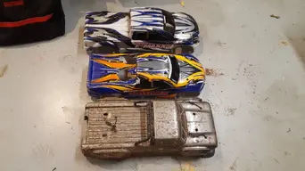

Most bodies that fit original wheel-base savage and T-maxx wI'll fit just fine. The downside is that most of the new extended wheelbase stuff will be too long. may get lucky and cut the bed off the back to make room for the wing and still make it look okay. to make other bodies look better you'll need to take the wing off, the way this thing pops wheelies, that may be hard to do...I've got a collection of original wheelbase bodies, let me see what I can dig up.
Here are some pics comparing e-maxx and T-maxx 2.5 and orange body is for HPI E-Savage body.
As you can see lot's of trimming to get the wing to fit. The shorter wheelbase bodies need less trimming. I found that running withought the wing puts alot of strain in the back of the bodies. Wheelies and bad landings will take its toll pretty quick.
E-maxx body is a little long. All three can be made to work.

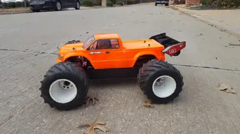

Hey guys. Took Outcast out for a hard bash today with a few bad landings and brutal high speed roll. Did a number on rear wing, ended up pulling out wing mount screw, then the other leaving me wingless for the rest of 6s dirt bash. Had already thought about replacing stock wing. Ended up replacing with Losi wing, fit perfectly, upgraded to 4mm button head screws, metal washers, and said, what the heck, fitted strong JConcepts Bajr body from monster slash. For those of you who've never run bug body, they tend to roll you back on your wheels so you don't do the walk of shame quite as often. Will lower front mounts a bit tomorrow and give her the old bash test. Anyone else strip wing mounting screws? Turns out the stock ones are pretty short and don't get much bite. Will post vids tomorrow in media. PS try not to land wing first using your wing to shovel the earth!
Hey guys. Took Outcast out for a hard bash today with a few bad landings and brutal high speed roll. Did a number on rear wing, ended up pulling out wing mount screw, then the other leaving me wingless for the rest of 6s dirt bash. Had already thought about replacing stock wing. Ended up replacing with Losi wing, fit perfectly, upgraded to 4mm button head screws, metal washers, and said, what the heck, fitted strong JConcepts Bajr body from monster slash. For those of you who've never run bug body, they tend to roll you back on your wheels so you don't do the walk of shame quite as often. Will lower front mounts a bit tomorrow and give her the old bash test. Anyone else strip wing mounting screws? Turns out the stock ones are pretty short and don't get much bite. Will post vids tomorrow in media. PS try not to land wing first using your wing to shovel the earth!View attachment 4201 View attachment 4202 View attachment 4203

I was at LHS yesterday and really liked the looks of Proline wing. A bit pricey, went with Losi cuz their cheap and had already fit tested with cracked spare, Losi snaps onto Outcast mount perfectly and sits totally flush for securement on wing mount nubs. Always in stock where I shop, wing is semi disposable if you bash hard, mine have absorbed 60mph Backslash tumbles on pavement. Sticking with it she passes decent bash testing. Stock wing is inadequate for protecting rear of stock body, should be a bit wider and taller IMO. Do like stock plastic though, wing never cracked or actually broke, unfortunately stock arrangement doesn't allow for nut lockdown of wing screws, leaves room for improvement.

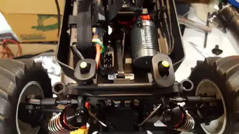

Just to follow-up on Losi wing with bigger 4mm screws and bug style body, bashed her pretty good today at local park with several rolls and tumbles, held up great. Will give her the big jump test soon. Rigged a body support extension, velcros on, used extra plastic foot from home depot snap together shelving, foam padding, tape, cut to sit just below top of body. Fugly, but worked great as hard lid first landings make bug bodies bowl inward, have to remove shell to pop back up, not with padded support. Will post vid later, uploaded a bit grainy for some reason. Temps were way cooler with improved airflow!

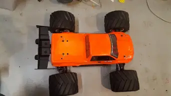

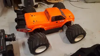

I like your body support idea, will be making something similar. Did get the orange body fitted to the short wheelbase chassis ( this is a monster typhon project)
Using senton front body mounts and outcast rear body post, the wing is a modified typhon wing. Using outcast wheely bar.
Trimmed the rear of the body to clear the wheely bar. The wing does a good job of absorbing the damage from crashes and the endless wheelies you get from high power short wheelbase trucks.

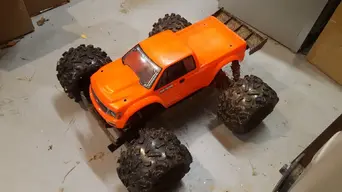

I had cut this body out awhile ago for a Backslash project, but never could figure out the fitment and gave up... Haha.
So now I might try to get it on my Outcast..
I'll probably struggle with fitment again and give up though... Lol
