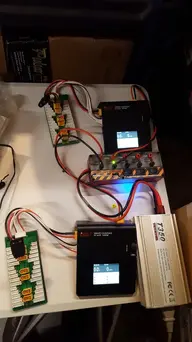

Here is my upgraded charger setup. 23A power supply running (2) ISDT 20A chargers. I got these on special from HK but there are many sources for them now. These will charge a 6S battery at over 8A. That's my new number. Now I can balance charge my packs in about 30 min. ISDT is a new kid on the block but the chargers are tiny, they have a single button click-wheel interface, don't run hot, have upgradeable software. They are only available in DC but in my experience DC chargers are more durable.
