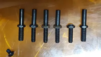

I broke my cantilever bolt on my NERO
The other three were bent. Those are the REVO post on the ends.

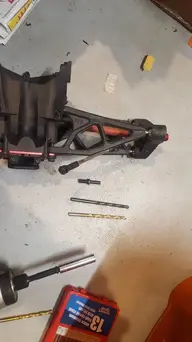

Well I went ahead and installed the traxxas revo rocker posts.
Used 13/64 drill bit to enlarge the hole
Used the 4-way wrench to install the new rocker post. The threads for the 4mm screw are not as deep on the traxxas parts. I believe this is the secret on why they don't snap off like the ARRMA parts. You also need to use a shorter 4mm screw on the top bearing. I used traxxas sealed bearings and screws to complete my install.
I can't notice any difference between ARRMA or the Traxxas REVO parts. Front is smonth rear is a little sticky exactly like the truck was before. The rockers move very smooth. Now I can go back ton running the NERO.
