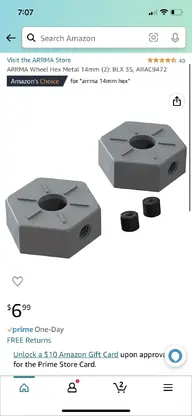

I found these but am not sure this is what I need ???
Those only work with proline raid wheels that have inner changeable hex inserts. So those are not it.
I remembered wrong because I’m not finding any 17 mm to 14 mm adapters. They probably don’t even exist.
Are the tires returnable? If not, You could always get a set of standard 3s axles like the granite, vorteks and big rock use and 14 mm hex to run these tires. Save the typhon part for when you get 17 mm tires eventually. They are silly expensive though. I have an extra set of axles I can happily send you, as well as 14 mm hex adapters. I’ll check for them in about an hour. Meanwhile, PM me please.
