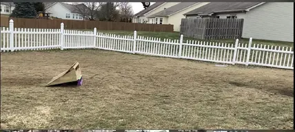

Anyway I had one of my youngiins do a “sloooow Moooo” vid of some backflips
And it’s crazy how much the chassis flexes when hitting the entirely to steep ramp!!!!!
I snapped some screenshots of the slow mo vid
Best I can do fer now !
