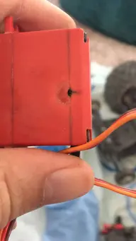

I bought my Nero BLX (brain less) about 6 weeks ago, not had much time with it, but I on about my 5th or 6th pack, my steering servo (AR390139) has become completely unresponsive.
Just wondering if any of you guys experienced this?
I've done some searching, but not seen any posts related to this issue.
Can you see that you're servo is not working?
Maybe you're servo saver get loose?
Yep I can see and hear it not working.
It's almost as if there's no juice or signal getting to it. I tried rebinding the receiver a few times, but nada. The truck accelerated and brakes fine.
You can swop the servo plug to ch3 and check if it´s not the receiver, but it really sounds that the servo had died.
Thanks buddy, yea it seems as tho the servo has burnt out... weird, I need to contact arrma and get some answers. Problem is I need to run it today, so I'll have to get a replacement from my local hobby store.

Arrma replaced my servo without a problem. I contacted them via email and got a response right away.
Thanks man. I emailed them and they gave 3 simple steps to follow.
I'm still kinda shocked the servo burnt out that quickly, I wonder if this is a common issue?
Trini, I had the same problem the other day. Steering just went completely out with no warning. Still drives forward and reverse but does absolutely nothing when trying to steer. Did the new servo fix your problem completely?
Sounds like the same thing I experienced, can you hear the steering servo moving? Even though it doesn't steer can you hear it working? If you can then it's not dead, maybe the horn or arm has come loose.
In my instance it was completely fried, so a new servo did the trick for me.
If you've done some digging and realise that the servo is indeed the issue, Arrma are pretty good with their responses and warranty, so I would contact them straight away and try to get it replaced.
I had the same problem and I just called arrma. Got a new one in the mail for free. If you don't have warranty try tightening the big wheel on the bottom of the car. I forgot what it's called but you can't miss it. It has a big spring and a turning wheel. Tighten it all the way with pliers.
