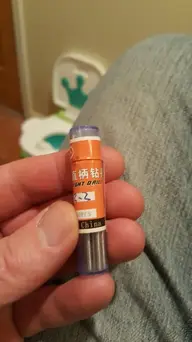

Just got my 2.2 drill blanks for the diffs.

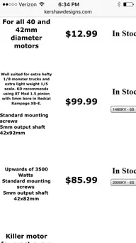

Just checked that motor from Kershaw designs. Was super stoked until I saw it only comes in 1480 kv....... ugggggg, I want it but cannot afford to buy 6s now. My Tekin rx8 died, two new motors that don't do the job, and 3 new 5s lipos.....

Would I be able to gear your setup high enough to run 5s. I believe you have it geared to the moon to get the speeds you want with 6s? I just want to enjoy it now and have it future proof for 6s eventually!

I need to get the drill bit blanks also, I'm rebuilding my diffs as we speak. I went with the aluminum diff housing.

I have to run a 20 tooth on the 1480KV on 6S. That will easily pull a 52mph run. My goal was a 50mph truck. I have a 19, 20, 21, and 22 tooth to play with. Motor temp is about 130-140 at the end of a run average so I feel the 20 tooth is the sweet spot on my motor. If it's too cool...you are not geared right also.
