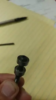

Im having the same issue! I cant get the head screw off of the rocker post!
Help
Use the included wrench and hold the nut part of post and take a hex driver and unsrew the button head.
I used to think it was one piece and i guess it isn't.
