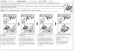

My manual says how to calibrate the esc.
