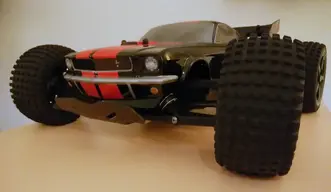

    It's almost too late to call this a build log.
    Started out with a beat up Typhon roller which I wanted to truggify and a Shelby GT 350 shell that was meant to go on my Outcast.
    Had a lot of Outcast parts in my spares box, found Talion 2018 shock towers on eBay and decided to build this thing completely from parts.

    That body fits neatly!

    Too low for my taste, and although body has a nice paint, not digging the car monster truck look.
    Thats just my opinion. It does look like a very well built project, and I bet you make a post on CL it sells quick.

    What brand is that body? I likey

    It's a HPI #17508

    It almost a perfect fit in the front, but the rear is a different story. Had to cut away quite a bit because of the short wheelbase of that 1/10 body.
