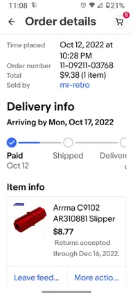

Trying to keep this extension build by using original parts but if I have to use a swb shaft I will.at least it's still from arrma. Also update on parts delivery.my extra BRcc body should be here today😆🤟then I can start this project.also waiting on the slipper shaft that I need to use to merge both shafts together.wont be here till Monday 😭I'll start on the body first .been thinking of a few ways to go about the body extension.lets see what I come up with👍

Second BRcc body cover has arrived boyz 😁 and the swb center drive shaft should be here today if not definitely tomorrow.now I can start my project..been thinking alot on how to go about this as there a few ways especially with the body.but I pretty much have what I need let's get to it.👍
