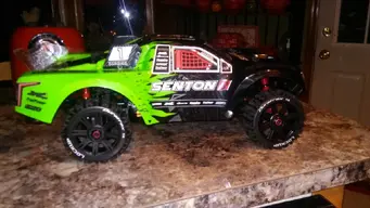

Thx man and yeah i figured that out.. waiting on a proline desert militia body and Badlands 40 series tires.. think it's gonna be bitchin'
This is what it looks like now.. I'll do a before and after.. only mods so far r the split six tires, stiffer springs front and rear and 65wt. in front 85wt. In back

Nice. Looking good. Should be a great all around truck with the wider hexes and bigger tires. I was thinking about doing the same thing to my V1 Senton. Still in the box... But I have a V2 Kraton on the way so I may just put 1/8th buggy tires on the Senton. Really like how all the Arrma platforms interchange. Can swap some parts around and make a custom vehicle.
