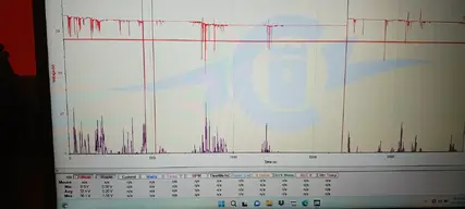

This is all new to me, so tell me what else you want pics of and how to navigate the log screen lol
Here's Voltage and Ripple

Those are some pretty big dips in voltage, which tells us that your batteries can’t handle the demand. I would get some bigger capacity, higher quality batteries.
It's not batteries, it does the same thing with 3 different sets/2 different brands, 2 of those sets got used YESTERDAY in a converted 5T with an XLX2/2028 combo that ran like a scolded dog...
