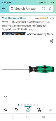

Try these I bought these screw extraction pliers for 18 bucks I think and I got the wera screw drivers in 2mm 2.5mm and 3mm screw drivers are a expendable item and should be replaced with signs of wear the weras are about 8 bucks a piece and can be replaced as needed but they are high quality and do have enough area to doctor up the tips once or twice if need be

Better pic of the wera driver
