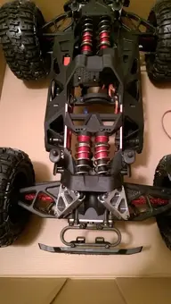

I put a 30 millimeter bolt and its place, you just don't have a spacer for the bearings. I did buy the GTA cantilever rockers and post studs. The pivot studs aren't tapped as deep so they're going to less apt of shear.
